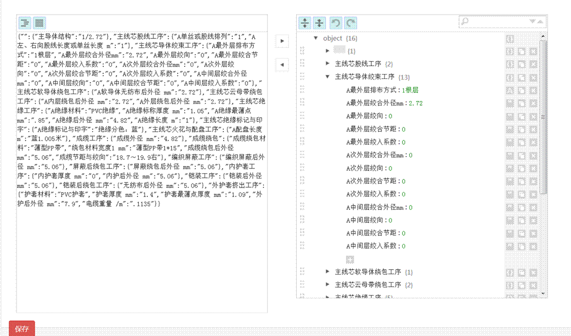

[5分]在ACCESS窗体里如何把文本显示成JSON格式
一念一如来  发表于:2019-04-25 10:50:17
如上图所示,左边的文本字符串如何在窗体里显现成右边的格式?
文本字符串举例如下:
{"":{"主导体结构":"1/2.72"},"主线芯股线工序":{"A单丝或股线排列":"1","A左、右向股线长度或单丝长度 m":"1"},"主线芯导体绞束工序":{"A最外层排布方式":"1根层","A最外层绞合外径mm":"2.72","A最外层绞向":"0","A最外层绞合节距":"0","A最外层绞入系数":"0","A次外层绞合外径mm":"0","A次外层绞向":"0","A次外层绞合节距":"0","A次外层绞入系数":"0","A中间层绞合外径mm":"0","A中间层绞向":"0","A中间层绞合节距":"0","A中间层绞入系数":"0"},"主线芯软导体绕包工序":{"A软导体无纺布后外径 mm":"2.72"},"主线芯云母带绕包工序":{"A内层绕包后外径 mm":"2.72","A外层绕包后外径 mm":"2.72"},"主线芯绝缘工序":{"A绝缘材料":"PVC绝缘","A绝缘标称厚度 mm":"1.05","A绝缘最薄点 mm":".85","A绝缘后外径 mm":"4.82","A绝缘长度 m":"1"},"主线芯绝缘标记与印字":{"A绝缘标记与印字":"绝缘分色:蓝"},"主线芯火花与配盘工序":{"A配盘长度 m":"蓝1.005米"},"成缆工序":{"成缆外径 mm":"4.82"},"成缆绕包":{"成缆绕包材料":"薄型PP带","绕包材料宽度1 mm":"薄型PP带1*15","成缆绕包后外径 mm":"5.06","成缆节距与绞向":"18.7~19.9右"},"编织屏蔽工序":{"编织屏蔽后外径 mm":"5.06"},"屏蔽后绕包工序":{"屏蔽绕包后外径 mm":"5.06"},"内护套工序":{"内护套厚度 mm":"0","内护后外径 mm":"5.06"},"铠装工序":{"铠装后外径 mm":"5.06"},"铠装后绕包工序":{"无纺布后外径 mm":"5.06"},"外护套挤出工序":{"护套材料":"PVC护套","护套厚度 mm":"1.4","护套最薄点厚度 mm":"1.09","外护后外径 mm":"7.9","电缆重量 /m":".1135"}}

AngelHis 发表于:2019-05-30 22:28:35
提供一个思路:
先需要自定义函数拆解字符串,然后字符串拆解后分配到数组或临时表里,最后用相应的记录集给树控件赋值即可。
一念一如来 发表于:2019-05-31 18:26:56
哦,谢谢先,用树控件的办法呀,我还想着有JSON的插件呢……
若用树控件的话,为了直观显示,用临时表或许也行的,我再重新设计设计啦
拆解字符串倒不需要,因为原始数据本来是单个的……
