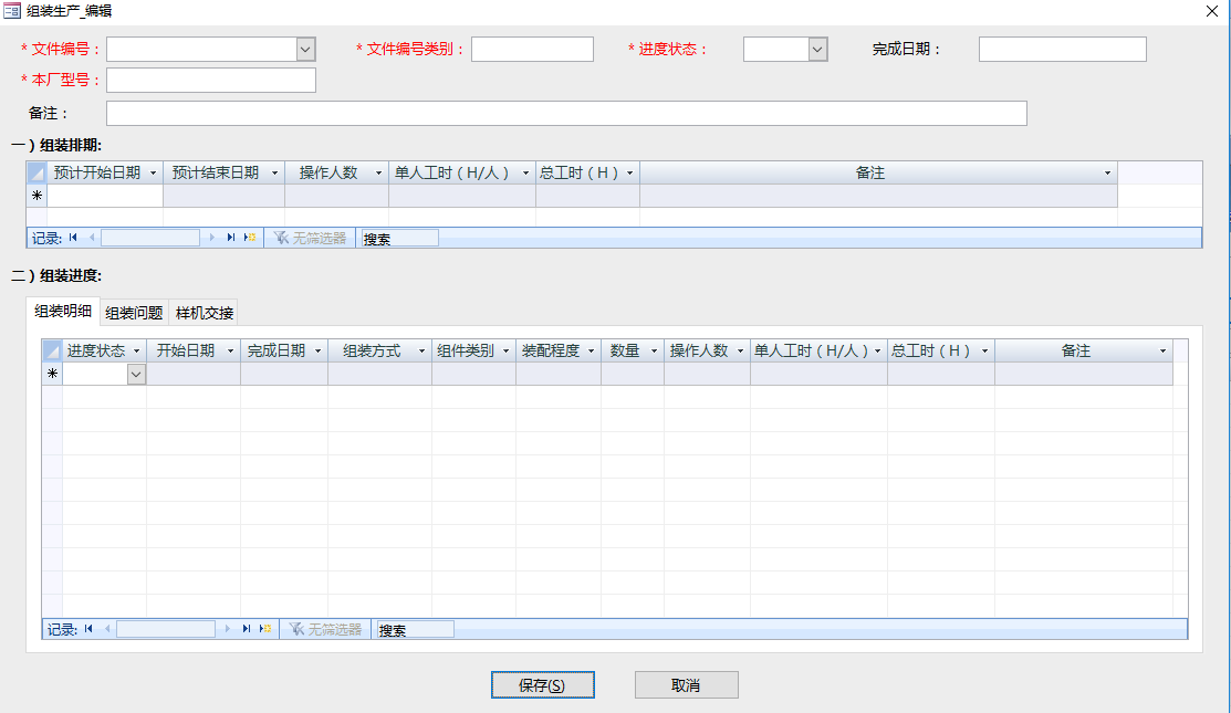

请问如何在平台中设计多个子窗体,论坛中有没有类似的例子。
对的。我知道新加一个子窗体需要写代码,但是没有案例,我不知道该怎么写,所以想看看是否有案例可以参考,同时我是按照论坛上的《铝件车间管理》里的一个写的,但是里面的子窗体有些不同,所以代码也不对。
用选项卡做,想学找我吧。打字你也理解不了
选项卡也不错,怎么找你学呢。

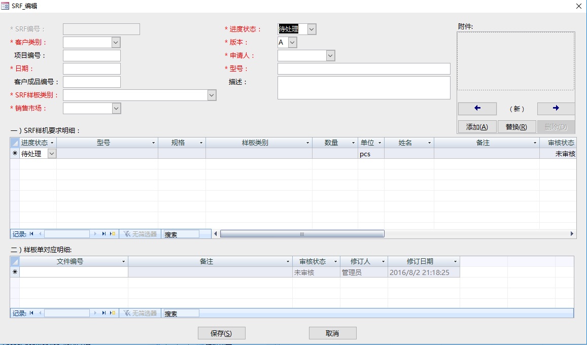

Private Sub Form_Load()
On Error GoTo ErrorHandler
Dim strSQL As String
Dim cnn As Object 'ADODB.Connection
Dim rst As Object 'ADODB.Recordset
Dim rstTmp As Object 'DAO.Recordset
ApplyTheme Me
LoadLocalLanguage Me
CurrentDb.Execute "DELETE FROM [TMP_TBL_SRF_YangBanXuQiu]"
CurrentDb.Execute "DELETE FROM [TMP_TBL_SRF_WenJianBianHao_MingXi]"
Me.sfrDetail.Requery
Me.sfrDetail_01.Requery
If IsNull(Me.OpenArgs) Then
Me.DataEntry = True
If Me.DataEntry Then
GoTo ExitHere
Me.btnSave.Enabled = Me.AllowEdits
Set cnn = CurrentProject.Connection
strSQL = "SELECT * FROM [TBL_SRF] WHERE [SRF_ID]=" & SQLText(Me.OpenArgs)
Set rst = OpenADORecordset(strSQL, , cnn)
Me![SRF_ID] = rst![SRF_ID]
Me![JinDuZhuangTai] = rst![JinDuZhuangTai]
Me![KeHuLeiBie] = rst![KeHuLeiBie]
Me![Ver] = rst![Ver]
Me![Project] = rst![Project]
Me![Requestor] = rst![Requestor]
Me![RiQi] = rst![RiQi]
Me![Model] = rst![Model]
Me![PartNo] = rst![PartNo]
Me![Description] = rst![Description]
Me![SampleType] = rst![SampleType]
Me![Market] = rst![Market]
Me![ShenHeZhuangTai] = rst![ShenHeZhuangTai]
Me![XiuDingRen] = rst![XiuDingRen]
Me![XiuDingRiQi] = rst![XiuDingRiQi]
rst.Close
strSQL = "SELECT * FROM [TBL_SRF_YangBanXuQiu] WHERE [SRF_ID]=" & SQLText(Me![SRF_ID])
Set rstTmp = CurrentDb.OpenRecordset("TMP_TBL_SRF_YangBanXuQiu")
Do Until rstTmp.EOF
rstTmp.Delete
rstTmp.MoveNext
Loop
Do Until rst.EOF
rstTmp.AddNew
rstTmp![ID] = rst![ID]
rstTmp![SRF_ID] = rst![SRF_ID]
rstTmp![JinDuZhuangTai] = rst![JinDuZhuangTai]
rstTmp![Model] = rst![Model]
rstTmp![GuiGe] = rst![GuiGe]
rstTmp![YangBanLeiBie] = rst![YangBanLeiBie]
rstTmp![QTY] = rst![QTY]
rstTmp![DanWei] = rst![DanWei]
rstTmp![XingMing] = rst![XingMing]
rstTmp![BeiZhu] = rst![BeiZhu]
rstTmp![ShenHeZhuangTai] = rst![ShenHeZhuangTai]
rstTmp![XiuDingRen] = rst![XiuDingRen]
rstTmp![XiuDingRiQi] = rst![XiuDingRiQi]
rstTmp.Update
rst.MoveNext
Loop
rst.Close
rstTmp.Close
strSQL = "SELECT * FROM [TBL_SRF_WenJianBianHao_MingXi] WHERE [SRF_ID]=" & SQLText(Me![SRF_ID])
Set rstTmp = CurrentDb.OpenRecordset("TMP_TBL_SRF_WenJianBianHao_MingXi")
Do Until rstTmp.EOF
rstTmp.Delete
rstTmp.MoveNext
Loop
Do Until rst.EOF
rstTmp.AddNew
rstTmp![WenJianBianHao] = rst![WenJianBianHao]
rstTmp.Update
rst.MoveNext
Loop
rst.Close
rstTmp.Close
'通过这一行代码的调用实现附件的加载
Call Me.sfrAttachments.Form.LoadAttachmentData("附件", Me!SRF_ID, cnn)
ExitHere:
Set rst = Nothing
Set cnn = Nothing
Set rstTmp = Nothing
Exit Sub
ErrorHandler:
RDPErrorHandler Me.Name & ": Sub Form_Load()"
Resume ExitHere
Private Sub btnSave_Click()
Dim strWhere As String
Dim blnTransBegin As Boolean
If Not CheckRequired(Me) Then Exit Sub
If Not CheckTextLength(Me) Then Exit Sub
If Not CheckRequired(Me.sfrDetail) Then Exit Sub
If Not CheckRequired(Me.sfrDetail_01) Then Exit Sub
'判断审核状态
If DLookup("ShenHeZhuangTai", "TBL_SRF", "SRF_ID='" & Me![SRF_ID] & "'") = "已审核" Then
MsgBox "已审核,禁止编辑!", vbCritical, "警告"
Exit Sub
cnn.BeginTrans: blnTransBegin = True
strSQL = "SELECT * FROM [TBL_SRF] WHERE [SRF_ID]=" & SQLText(Me![SRF_ID])
Set rst = OpenADORecordset(strSQL, adLockOptimistic, cnn)
If rst.EOF Then
rst.AddNew
rst![SRF_ID] = GetAutoNumber("SRF_ID")
rst![JinDuZhuangTai] = Me![JinDuZhuangTai]
rst![KeHuLeiBie] = Me![KeHuLeiBie]
rst![Ver] = Me![Ver]
rst![Project] = Me![Project]
rst![Requestor] = Me![Requestor]
rst![RiQi] = Me![RiQi]
rst![Model] = Me![Model]
rst![PartNo] = Me![PartNo]
rst![Description] = Me![Description]
rst![SampleType] = Me![SampleType]
rst![Market] = Me![Market]
rst![ShenHeZhuangTai] = Me![ShenHeZhuangTai]
rst![XiuDingRen] = Forms!sysfrmMain!Nickname
rst![XiuDingRiQi] = Now()
rst.Update
rst.Close
Do Until rst.EOF
rst.Delete
rst.MoveNext
Loop
Do Until rstTmp.EOF
rst.AddNew
rst![SRF_ID] = Me![SRF_ID]
rst![JinDuZhuangTai] = rstTmp![JinDuZhuangTai]
rst![Model] = rstTmp![Model]
rst![GuiGe] = rstTmp![GuiGe]
rst![YangBanLeiBie] = rstTmp![YangBanLeiBie]
rst![QTY] = rstTmp![QTY]
rst![DanWei] = rstTmp![DanWei]
rst![XingMing] = rstTmp![XingMing]
rst![BeiZhu] = rstTmp![BeiZhu]
rst![ShenHeZhuangTai] = rstTmp![ShenHeZhuangTai]
rst.Update
rstTmp.MoveNext
Loop
rst.Close
rstTmp.Close
Do Until rst.EOF
rst.Delete
rst.MoveNext
Loop
Do Until rstTmp.EOF
rst.AddNew
rst![WenJianBianHao] = rstTmp![WenJianBianHao]
rst.Update
rstTmp.MoveNext
Loop
rst.Close
rstTmp.Close
cnn.CommitTrans: blnTransBegin = False
'通过这一行代码的调用实现附件的保存
Call Me.sfrAttachments.Form.SaveAttachmentData("附件", Me!SRF_ID, cnn)
Form_frm_SRF.RefreshDataList
MsgBoxEx LoadString("Saved Successfully."), vbInformation
' If Me.DataEntry Then
' ClearControlValues Me
' CurrentDb.Execute "DELETE FROM [TMP_TBL_SRF_YangBanXuQiu]"
' Me.sfrDetail.Requery
' Else
DoCmd.Close acForm, Me.Name, acSaveNo
' End If
ExitHere:
Set rst = Nothing
Set cnn = Nothing
Exit Sub
ErrorHandler:
If blnTransBegin Then
cnn.RollbackTrans
RDPErrorHandler Me.Name & ": Sub btnSave_Click()"
Resume ExitHere
多个窗体改为选项卡时,只需要将相应的子窗体移动到选项卡上,代码不需要更改。
