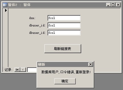

代码刷新链接表为什么总是提示密码错误?后台数据库为sql server2005

代码如下:
Private Sub Command9_Click()
    Err = 0
    On Error Resume Next
    Dim wrkODBC As Workspace
    Dim conPubs As Connection
    Dim mydb As Database, mytable As TableDef
    Dim i As Integer, j As Integer
    Dim connectstr As String
    DoCmd.Hourglass True
    DoCmd.SetWarnings False
    Set mydb = DBEngine.Workspaces(0).Databases(0)
    Dim passdb As String, ww As Integer
    Dim f As Integer, g As Integer
    connectstr = "ODBC;DSN=" & Me.dsn & ";"
    connectstr = connectstr & "UID=" & Me.dbuser_id & ";"
    connectstr = connectstr & "PWD=" & Me.dbpass_id & ";"
    Set wrkODBC = CreateWorkspace("NewODBCWorkspace", "", "", dbUseODBC)
    Set conPubs = wrkODBC.OpenConnection("sam_user", dbDriverNoPrompt, , connectstr)
    If Err <> 0 Then GoTo dbuser_sam_err
    On Error GoTo dbuser_conn_err
    i = mydb.TableDefs.Count     'tables count
    For j = 0 To i - 1
        Set mytable = mydb.TableDefs(j)
        If mytable.Attributes = DB_ATTACHEDODBC Or mytable.Attributes = DB_ATTACHEDODBC + DB_ATTACHSAVEPWD Then
            mytable.Connect = connectstr
            mytable.RefreshLink
    Next
    DoCmd.Hourglass False
    MsgBox "数据表连接完成!", , "刷新"
    Err = 0
    Exit Sub
dbuser_sam_err:
    MsgBox "数据库用户,口令错误,重新登录!", , "刷新"
    Err = 0
    Exit Sub
dbuser_conn_err:
    MsgBox Error$(Err), 16, "刷新"
    Err = 0
    Exit Sub
提示错误如下:

bjllk 发表于:2014-08-04 17:29:53
谢谢老师回复,但同还是提示出错,把Error GoTo注释掉后显示为连接数据库失败,如图示:
